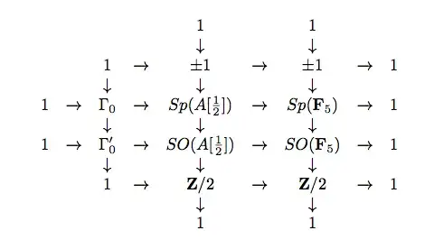

Finally we have a commutative diagram in which all rows and columns are exact :
So the groups $\Gamma_0$ and $\Gamma_0'$ are isomorphic. Now $SO(A[\frac 12])$ has virtual Euler-Poincaré characteristic $$\chi_v( SO(A[\frac 12]))=\frac{1}{60}+\frac{1}{24}-\frac{1}{12}=-\frac{1}{40}$$ and $SO(\mathbf F_5)$ has order $120$, so we obtain $$\chi_v( \Gamma_0')=-{3}\ \ \ .$$ Since $\Gamma_0'$ has no torsion, we deduce that it is a free group on $4$ generators ... the ones that correspond to the quaternions (different from $1$) you gave in the OP.
