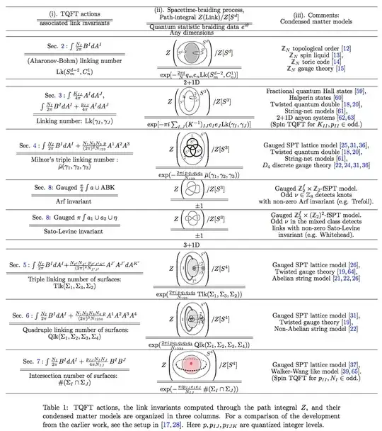

Try this article:
Braiding Statistics and Link Invariants of Bosonic/Fermionic Topological Quantum Matter in 2+1 and 3+1 dimensions by Pavel Putrov, Juven Wang, Shing-Tung Yau
Annals of Physics 384C, 254-287 (2017)
https://arxiv.org/abs/1612.09298
It explains many interesting link invariants and their relations to braiding statistics of anyons in 3d spacetime and anyonic strings in 4d spacetime in Quantum Matter (condensed matter and lattice models) and Quantum Field Theories:
