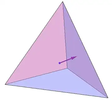

Suppose you were standing inside a regular tetrahedron $T$ whose internal face surfaces were perfect mirrors. Let's assume $T$'s height is $3{\times}$ yours, so that your eye is roughly at the centroid, and that you look perpendicular to a face:
          TetraViewPoint
My question is:
Q. What do you see? Either qualitatively; or if anyone can find an image, that would be revealing.

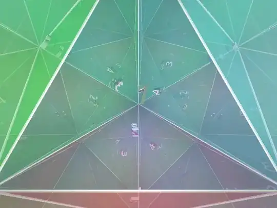

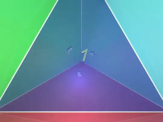

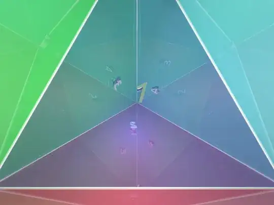

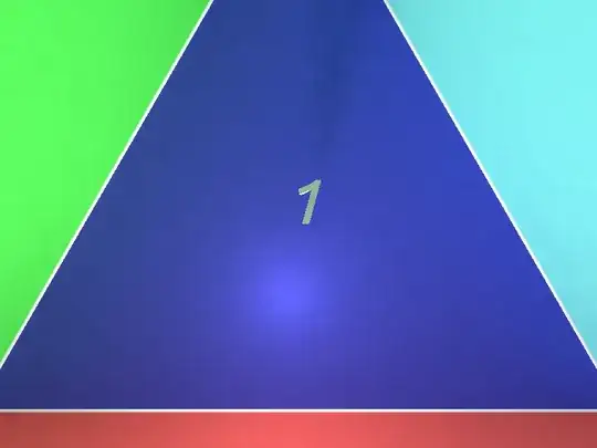

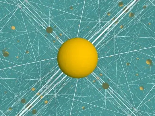

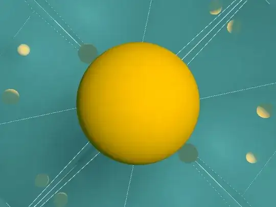

Here are a couple pictures. If you'd like to do more, I created this with a simple povray script. Feel free to e-mail me and I'll send it to you.
With four reflections.
With 8 levels of reflections.
One with 24 reflections.

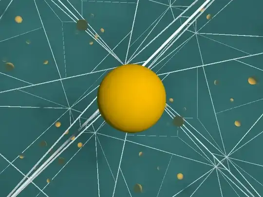

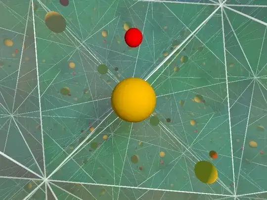

And one with 32 reflections, and each mirror having a slightly different tint, a red sphere, and a slightly wider viewing angle.

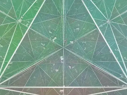

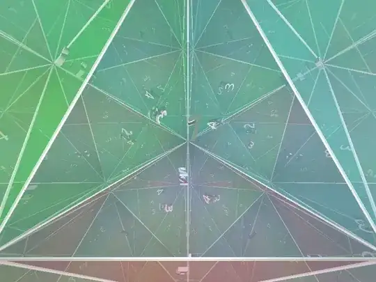

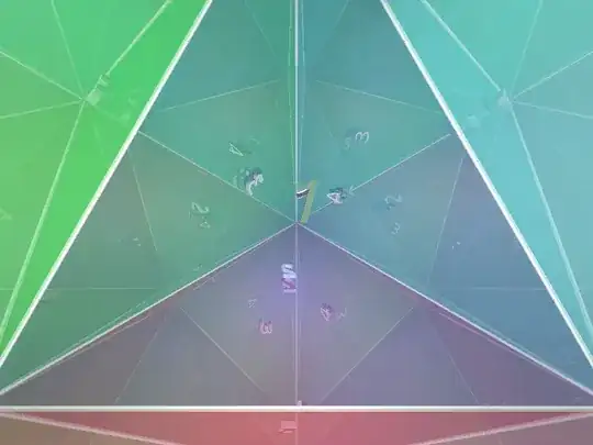

Here is the view from inside a mirrored tetrahedron, near one of the vertices, looking towards the opposite face. Near the centre of each face is a number indicating which vertex the triangle is opposite. The sequence shows the triangles becoming more reflective and less opaque. The field of view is 120 degrees so there is a little bit of lens distortion at the fringes of the image.
enter image description here enter image description here enter image description here enter image description here enter image description here enter image description here enter image description here
And here is the link to the scripts for the tetrahedra with the numbering and without the spheres.

  • I'll upload some images with deeper reflections soon. They're taking a little longer to render. – Ryan Budney Nov 21 '14 at 01:48
  • Nice, Ryan!!! Try: global_settings { max_trace_level depth }. PovRay allows depth as large as $256$. – Joseph O'Rourke Nov 21 '14 at 01:57
  • Wow! Surprisingly complex and irregular. – Joseph O'Rourke Nov 21 '14 at 02:02
  • At 20+ reflections it starts to look a little like an orb-weaving spider web, strangely enough. But not quite as symmetric. – Ryan Budney Nov 21 '14 at 02:04
    I suppose I might as well make an mpeg movie out of this. I'll put it up on my webpage in a day or two, whenever it finishes rendering. :) – Ryan Budney Nov 21 '14 at 02:08
  • I assume the white lines are edges between faces? – Joseph O'Rourke Nov 21 '14 at 02:13
  • Yes, and the slightly fatter white blobs are the vertices. There's one orange sphere at the centroid, and the camera is slightly off-centre, looking towards the centre. – Ryan Budney Nov 21 '14 at 02:14
  • Could you put a layer of colored plastic on each of the interior faces? – Allen Knutson Nov 21 '14 at 03:58
  • So we know one face from another? Sure, let's try that.... – Ryan Budney Nov 21 '14 at 04:06
    Please post the pov-ray script! Also, is there some way to model a simple stick-figure person, in order to help answer the question of what it would look like if a person were inside the tetrahedron? Then we could see variation in which way is up in the reflected images; and ideally back vs. front. – LarsH Nov 21 '14 at 16:58
    Will post it tonight, once I'm back at home. I think I'll add some near-transparent numbers to the faces so that we can keep track of where the reflections are coming from. – Ryan Budney Nov 21 '14 at 19:15
    Here is the current version of the script. I'll update it as this discussion evolves: https://www.dropbox.com/s/7vtl554pjdt6mpa/orourke.pov?dl=0 – Ryan Budney Nov 22 '14 at 03:06
  • I'm a bit disturbed by the fact that some of those spheres appear as ellipses on your pictures. That surely can't be right... – André Henriques Nov 24 '14 at 12:43
    I think that's just "fish eye lens effect". Notice it primarily happens out towards the edges in the last image, which has the widest field of view (90 degree viewing angle). The previous images had a 60 degree viewing angle, which results in less distortion. – Ryan Budney Nov 24 '14 at 14:42
  • Here is the same sequence as the last, but using balls instead of numbers: https://www.dropbox.com/sh/kegz80c7r8h3avj/AADIXhRxsZSY4oG8pPElYqW5a?dl=0 My first animation should be complete sometime tonight. I'll put that up on my math blog. – Ryan Budney Nov 26 '14 at 22:18

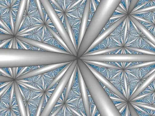

There is a software by Jeff Weeks, Curved Spaces which allows for flying through various such spaces. It includes a mirrored tetrahedron but with $\pi/2$ dihedral angles. One can construct own spaces though, by providing a list of 4$\times$4 matrices generating the (linearized version of the) transformation group.
Snapshot:
(obviously not that inspiring, you have to see it in motion to really appreciate)
Addendum
After several unsuccessful attempts to realize the Euclidean tetrahedron in the program I contacted Jeff Weeks; it turned out that unfortunately Curved Spaces cannot handle noncompact groups.
Jeff also mentioned the spherical case - regular spherical tetrahedron with dihedral angles $2\pi/5$, whose face reflections fill up the 600-cell. It occurred to me that this is a rare situation when the Euclidean case (dihedral angle $\arccos 1/3$) is the most pathological between the nearest "non-pathological" cases - spherical case mentioned above and the hyperbolic case (dihedral angle $\pi/3$). A wonderful picture of the latter may be found in the Wikipedia chapter "Order-6 tetrahedral honeycomb"
An additional question then - is the Euclidean case in any sense a quotient of this?
    No, symmetry groups do not match. As you noted yourself, the 600-cell thing features 5 tetrahedrons sharing an edge (2π/5 = 72° dihedral angle) and the hyperbolic case features 6 tetrahedrons sharing an edge (π/3 = 60° dihedral angle). Whereas dihedral angle in Euclidean case is irrational. This means that: • in spherical case, five reflections about faces adjacent to the same edge compose to an isometry (orientation-reversing) of the tetrahedron; • in hyperbolic case, six reflections about faces adjacent to the same edge compose to identity transform; • nothing like this in Euclidean case. – Incnis Mrsi Apr 05 '15 at 13:02
  • @IncnisMrsi You are right - I formulated it vaguely since I don't know what precisely I mean, but here is a simplified version: look at quotients of the unit circle in $\mathbb C$. Quotient by (the subgroup generated by) $e^{\frac{2\pi i}5}$ is a circle, and by $e^{\frac{2\pi i}6}$ is another one, but one might also form quotients by all intermediate elements lying in between, including irrational ones, to obtain a family of quotients (most of them pathological) connecting these two cases. I was thinking maybe one could play similar game with quotients of the hyperbolic space... – მამუკა ჯიბლაძე Apr 05 '15 at 19:06
