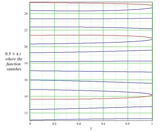

  • when $z \rightarrow 0$, the function reduces to $\Gamma(s) \pm \Gamma(1-s)$, for which it has been proven here that all complex zeros in the strip are on the critical line (and only a finite number lie outside the strip). Additional observation 1: I found that by gradually increasing $z$ from $0$ to $1$ and for each step calculating the 'adjacent' zeros (that I still find to all reside on the line $\Re(s)=\frac12$), their imaginary parts $s$ seem to follow a path connecting a zero of $\Gamma(s) - \Gamma(1-s)$ when $z \rightarrow 0$, uniquely to a zero of the function at $\Gamma(s)\zeta(s) - \Gamma(1-s)\zeta(1-s)$ when $z \rightarrow 1$. The following graph shows these paths with $z$ on the horizontal axis increased by steps of $0.02$ and the imaginary part $s$ at values in $\frac12 + s \,i$ where the function vanishes. The paths that lead to the non-trivial zeros are marked in red. Also tried a similar plot for $z$ decreasing from $0$ to $-1$ and although the paths seem to nicely continue for all non-trivial zeros, I did find that some of the other zeros on the line $z=0$ do not map to zeros on the line $z=-1$ that equals $\Gamma(s)\eta(s) - \Gamma(1-s)\eta(1-s)$.

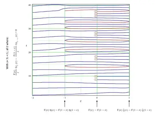

Additional observation 2: Here is more complete picture of where the function vanishes at imaginary values $t$ when $s=\frac12 + t i$:
The one-to-one connection between the zeros at $z \rightarrow 0$ and $z \rightarrow 1$ appears to be pretty robust, however the connection between $z \rightarrow 0$ and $z \rightarrow -1$ is much more chaotic (although the lines coming from the far left all firmly pass through). Clearly not all zeros of $z=-1$ match with zeros at $z=0$, however it does appear that all lines starting at non-trivial zeros on the $\eta$-line $(z=-1$), do have a path to the $\Gamma$-line $(z=0)$. The lines on the right marked with a little cross actually do run a bit further towards $z=-1$, but never make it to the 'other side'. I also found there do exist zeros lying off the critical line and in the strip around the spot where the path of these lines at $s=\frac12+t i$ strands (e.g. for: $0.1809532919+9.053131045 i$ at $z=-0.82$ or $0.5580702805+36.69087427 i$ when $z=-0.8$).
