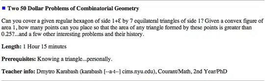

It seems that Dmytro Karabash might be a source on this topic. A 2010 NYU course of lectures included a talk by him whose description matches your problem statement exactly:
     Karabash50
