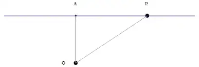

An example that illustrates a slightly different integral is the following.
An observer at point $O$ is exposed to traffic noise from a long straight highway (the line $AP$). The task is to show that the total noise level at $O$ is inversely proportional to the distance $r=|OA|$ from the highway.
Use the following approximations/simplifications.
  • The traffic density is constant along the road (a kind of an average).
  • The level of "atomic noise intensity" at $O$ follows the inverse square law (this is probably a good approximation you can easily justify).
  • The total noise intensity is the sum of the infinitesimal/atomic noise intensities (i.e. the quantity measured in Watts per square meter is additive. You only switch to the logarithmic decibel scale afterwards if ever, as things are not additive on the decibel scale).
So if you place $x$-axis along the road, and $P$ is at $x$, then the noise generated along a segment of the road of length $dx$ around $P$ has (at a unit distance from $P$) intensity $K\,dx$ for some constant $K$ proportional to traffic density (= number of passing vehicles per hour). When we take the distance $|OP|=\sqrt{r^2+x^2}$ into account we get $$ dI=K\,\frac{dx}{r^2+x^2} $$ for the contribution of this atomic noise to the total observed noise level at point $O$. The total noise intensity is thus $$ I=\int dI=\int_{-\infty}^{\infty}K\,\frac{dx}{r^2+x^2}. $$
So you get to illustrate/discuss:
  • improper integrals
  • indefinite integral of a simple rational function
  • discuss what goes wrong when $r\to0+$ (the approximations fail, and you cannot be at distance zero from a continuous source of the noise)
  • point out that a similar (but also different) integral emerges when you calculate the field generated by an electric current along a long straight wire
I have tried this both as an in class and as a homework example. As a HW problem it did create some discussion as the physics majors protested at first (assuming that I was adding decibels together). I guess the non-physics majors may have been bored. You know your customers (and if somebody can add an example from chemistry I will be very grateful).
