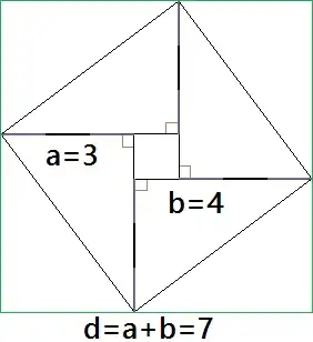

The Chinese came up with the following a long time ago. Probably something better, but this is the gist of it.
  1. Let's start with a right triangle with height b=4 and base a=3. We know it has some hypotenuse, c, but we don't know it's length because that's what we're trying to prove.
Right triangle, b=4, a=3.
  1. Now we're going to make 3 copies, and rotate them each 90°.
Original plus 3 copies rotated 90° each.
  1. Next we're going to shove them all together so their sides touch. Because we defined them as right triangles, and rotated them exactly 90°, we know all the sides that are touching are parallel.
Four right triangles making a square.
  1. Finally, we construct a square around the entire construct, ensuring the sides are parallel/perpendicular to the a/b sides of the right triangles.
Big square surrounding the angled squares.

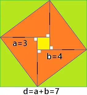

Here I've shaded it.
Shapes are filled in with color.
  1. We can see that the sides of the large square must be a+b = 7 in length. Necessarily, the area of the square (green+orange+yellow) is 49.
  2. One of the orange triangles forms a rectangle with a green triangle, with sides 3 by 4, so the area of either an orange triangle or a green triangle is (3*4)/2 = 6.
  3. The four green triangles have a total area of 6*4 = 24. The area of the middle square (orange+yellow) must be 49-24 = 25. Alternately, you could just add the obviously 1*1 = 1 area of the central square (yellow) to the area of the orange triangles which is also 6*4 = 24, for a total of 25.
  4. Because of symmetry, the sides of the middle square must be length c. We know the area of the square is c^2 and we also know it's 25, so c^2 = 25. Because 5^2 = 25, c=5. We've also managed to show at least one case of Pythagorean's theorem is true in the process.

    Isn't this just a proof of the Pythagorean theorem, which the question specifically asks not to use? – Javier Oct 28 '15 at 11:25
    @javier No, this doesn't use PT, but it does look almost as complex as PT. With little extra effort it is one of the classic proofs of PT. It may be that what I'm asking for ends up being equivalent to proving PT. I'm hoping for something simpler (like a one-off diagram of a dissection). – Mitch Oct 28 '15 at 13:31
    This is the only thing posted so far that doesn't rely on an "eyeballing" argument. The argumentation is similar to a proof of PT. But that's because it has to be. – Tim Seguine Oct 28 '15 at 15:01
    After step 3, instead of drawing a big square around the whole picture (step 4), you could use the fact that you've already got a $c$-by-$c$ square. All four sides are $c$, and all the angles are right because you rotated the original triangle in $90^\circ$ increments. Then you can finish the proof by saying that the area of this square is, on the one hand, $c^2$ and, on the other hand, $(4\times6)+1=25$ (from the 4 triangles of area 6 each, plus the 1-by-1 square in the middle). So $c=5$. – Andreas Blass Oct 28 '15 at 20:06

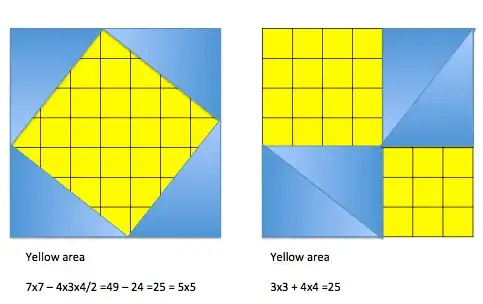

Graph paper (or square floor tiling) to the rescue!
Proof by picture for a 3 4 5 triangle:
Because the drawing is on the grid and not the skew tiling of the square on the hypotenuse, determining the area is not inscrutable. The blue square (it is a square by adding angles of the triangle) is area 25 by adding the four blue triangles (obviously 6 each) and the single unit square in the middle.
And of course this can be immediately generalized to any right triangle.
Although I asked for the determination of the largest angle of the 3 4 5 triangle (and this visual proof shows the other direction that the hypotenuse is a square on 5), I think the visual intuition is enough to go both directions, that showing a 3 4 rt triangle has hypotenuse 5 is enough (intuitively) to show the 3 4 angle of a 3 4 5 triangle is right.

I would think you'd approach it the reverse direction: Draw a side straight up of length 4, draw another straight to the right of length 3, and then calculate the distance between the ends and show that it's 5--assuming you have the distance formula or permit yourself to measure the line lengths physically.

    If you have graph paper, it's not difficult to show that the square of the hypotenuse is 25, – Dag Oskar Madsen Oct 27 '15 at 23:26
  • @DagOskarMadsen Duh! And that picture also leads directly to the general (visual) proof. – Mitch Oct 28 '15 at 19:07
