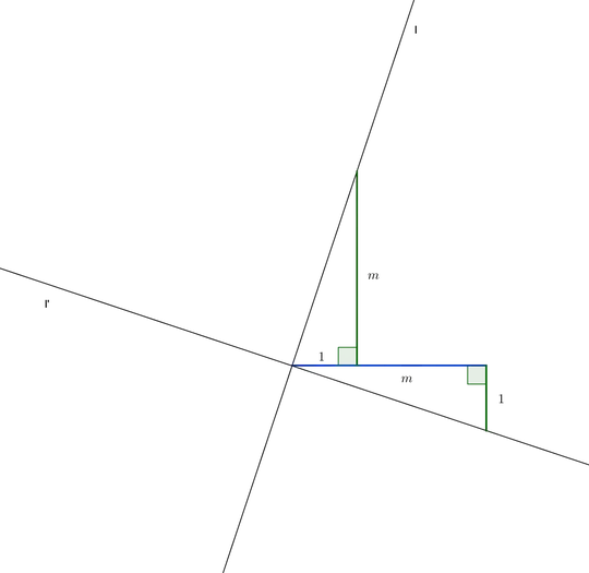

If we have two lines $l$ and $l'$ with slopes $m>0$ and $m'= - \tfrac 1 m$ respectively, then we can always make the following diagram
where the blue line is parallel to the $x$-axis and the green lines are parallel to the $y$-axis. That the lines $l$ and $l'$ are perpendicular now follows from that the two triangles are congruent and that the sum of angles in a triangle is $180^{\circ}$. The Pythagorean Theorem is not needed.
For the converse, we can use almost the same diagram. Assume the lines $l$ and $l'$ are perpendicular and $l$ has slope $m>0$. We can then make the diagram
where the blue line is still parallel to the $x$-axis and the green lines are parallel to the $y$-axis. This time an Angle-Side-Angle comparison shows that the two triangles are congruent. Therefore $BD=1$, and the slopes are negative reciprocals of each other.

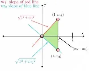

A proof following from the Pythagorean Theorem:
Claim: If two lines are perpendicular, then their slopes are negative reciprocals of one another.
Proof: Assume WLOG that two nonvertical lines with slopes $m_1$ and $m_2$ intersect at the origin and form a right angle. Construct the line $x=1$. Then we have a triangle with coordinates $(0,0)$, $(1,m_1)$, and $(1,m_2)$. Moreover, the triangle is a right triangle with legs $\sqrt{1^2+m_1^2}$ and $\sqrt{1^2+m_2^2}$, and hypotenuse $(m_1-m_2)$.
By the Pythagorean theorem:
$$\sqrt{1^2+m_1^2}^2+\sqrt{1^2+m_2^2}^2=(m_1-m_2)^2$$ $$2+m_1^2+m_2^2=m_1^2-2m_1m_2+m_2^2$$ $$2=-2m_1m_2$$ $$\frac{-1}{m_1}=m_2$$
Pythagorean Theorem and Slope

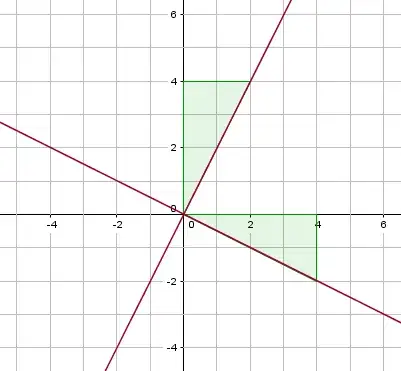

One slightly different perspective, but with most of the same mechanics, is to imagine any set of perpendicular lines as having been translated and/or rotated from the x- and y-axes.
perp lines with slopes
If you pick any point on one line and form a triangle with the nearest axis, then because they've both rotated the same angle, the other line must form the same triangle with the other axis. This triangle, though has its rise and run swapped and a left-to-right run has become a top-to-bottom drop. So the slope must be the negative reciprocal.
