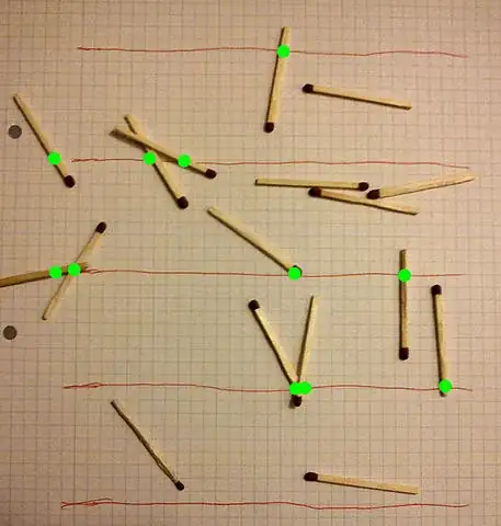

It can be powerfully impressive to approximate $\pi$ by dropping matchsticks on a ruled surface:
      Buffon
      Wikipedia image by McZusatz.
Here, $17$ sticks were tossed, the separation between the lines is the stick length, and $\pi \approx (2 \cdot 17) / 11 = 34/11 \approx 3.1$. See, e.g., this description.
