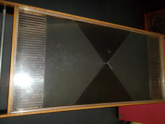

I would use a quincunx (also known as Galton board). I realize that has been answered before, but here I will give some images of how a quincunx could look like. First a photo (by myself) of a very large quincunx in the science museum http://www.universum.unam.mx/ in the large UNAM camp in south Mexico City:
This is very large, about three meters long if I remember right, and works by being tipped like a childrens seesaw. Below another image showing better the principle:
