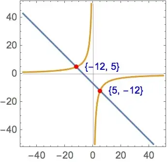

          Hyperbola
$$x+y = -7, \;\; \text{and} \; \; x y = -60 \;.$$
