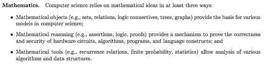

These two references might help. Neither is aimed at industry needs specifically, but undergraduate computer science curricula are partially driven by industry job market needs. The first is aimed specifically at liberal arts colleges:
(1) "A 2007 Model Curriculum for a Liberal Arts Degree in Computer Science," Liberal Arts Computer Science Consortium, 2007. (PDF download link.)
Here is an excerpt; more detail in the report:
ACM07
The second is more recent, and not specific to liberal arts colleges (but agrees with the above):
(2) "Computer Science Curricula 2013: Curriculum Guidelines for Undergraduate Degree Programs in Computer Science." 2013. (PDF download link.)
Here is a snippet (p.467) of topics coverage, all of which are required at "Tier-1" universities:
          ACMTopics
