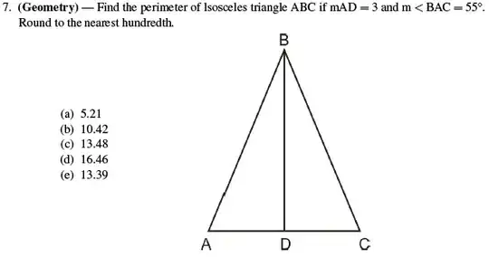

Update to the "no trig" comment - this question is in CK-12's SAT Flex Prep Book.
To solve exactly, the trig functions are needed. But. If angle A were 45$^\circ$, I'd know the base was 6, and the sides each $3\sqrt{2}$. That's about 14.4. With only one answer greater than 14.4, The answer D is obvious. And, in my opinion, avoids the not so small risk that the calculator is set to radians.
