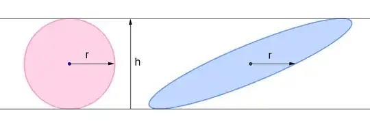

I've always been surprised by this way of measuring the area of an ellipse. Instead of the classical use of the semi-major and semi-minor axes, you can actually do something similar to what you do with a parallelogram:
Draw two parallel lines that just touch the ellipse on the outside. We'll say these lines are horizontal. We'll call the distance between these lines h. Halfway between them, measure across your ellipse horizontally. Let's call half this width r. Then the area of the ellipse is $\pi r (\frac12 h)$. It's particularly impressive when $h=2r$ because then the area is just $\pi r^2$.
This works because your ellipse is a shear of another ellipse with the same height and horizontal radius. In essence because of the 2D version of Cavalieri's principle.

  • Nice! How hard is it to show that any two ellipses with the same height and horizontal radius have all the same horizontal cross-sections? – Mike Shulman Sep 24 '14 at 17:15
  • Hmmm. Not sure at this stage. My understanding is actually in the other direction, which is much easier to show: a shear of any shape preserves horizontal cross-sections, and a shear of an ellipse is still an ellipse. – DavidButlerUofA Sep 24 '14 at 22:43
  • Ok; am I wrong, then, that you'd need to know that any two ellipses with the same height and horizontal radius have the same horizontal cross-sections in order to actually calculate the area of an ellipse this way? – Mike Shulman Sep 25 '14 at 23:24
  • What about this: given an ellipse with particular height and horizontal radius, show that there is a shear of this ellipse which is a "standard" ellipse. Since shearing preserves horizontal cross-sections, the area must be the same by Cavalieri's principle. – DavidButlerUofA Sep 26 '14 at 03:43

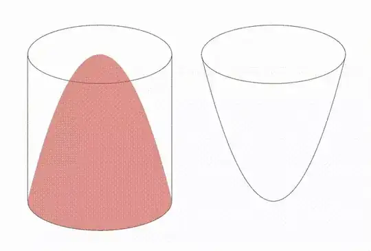

This example here I discovered myself:
Consider a cylinder of radius $r$ and height $h$, circumscribing a paraboloid $y=h\left(\dfrac{x}{r}\right)^2$ whose apex is at the center of the bottom base of the cylinder and whose base is the top base of the cylinder.
Also consider the paraboloid $y=h-h\left(\dfrac{x}{r}\right)^2$, with equal dimensions but with its apex and base flipped.
For every height $0\le y\le h$, the disk-shaped cross-sectional area $\pi\left(\sqrt{1-\frac{y}{h}}\,r\right)^2$ of the flipped paraboloid is equal to the ring-shaped cross-sectional area $\pi r^2-\pi\left(\sqrt{\frac{y}{h}}\,r\right)^2$ of the cylinder part ''outside'' the inscribed paraboloid.
Therefore, the volume of the flipped paraboloid is equal to the volume of the cylinder part ''outside'' the inscribed paraboloid. In other words, the volume of the paraboloid is $\dfrac{\pi}{2}r^2h$, half the volume of its circumscribing cylinder. The volume of the paraboloid is half the volume of its circumscribing cylinder.
