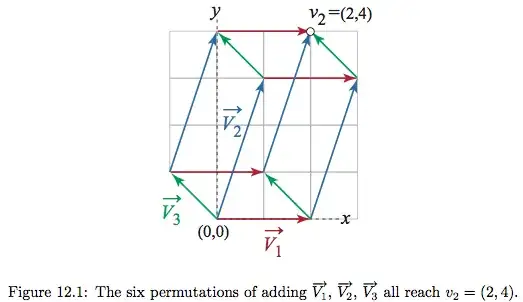

I recognize that this is not directly answering the question, but I'll proceed regardless. I have had some success conveying some aspects of vectors to middle-school children (in the U.S.: 8th-9th grade), in the context of robot-arm motion in the plane.
          HTFIFig12.1
The figure above (from How To Fold It) is an attempt to illustrate the commutativity of vector addition, which implies that a robot arm's links can be permuted without altering the reachable endpoints. Once one accepts this invariance under permutations, non-obvious lemmas can be proved.
