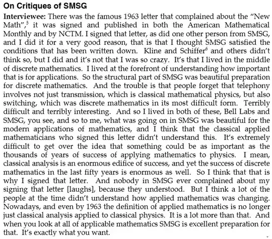

Recap: "New Math" would have been influenced by, among other mathematicians, SMSG's director, Ed Begle, who was fond of the sort of notation you allude to when you ask about set theory. However, I'd like to return briefly to Pollak and another article in The International Journal for the History of Mathematics Education, available for free here (pdf). In particular, allow me to highlight the following two excerpts:

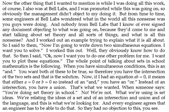

The "interviewee" above is Henry Pollak, and you can find in the article the foot-noted items. The real item of import is in the subsequent paragraph, and the point made that it was not so much about using set theory but rather about using "set ideas":
This conception of the ideas in "New Math" provides, perhaps, some support for JPBurke's conjecture about an over-focus on "set theory" in NM as overly abstract by its critics, whereas - at least in the case of Pollak, who worked with SMSG - the real motivation may have come from a more "applied" setting.
