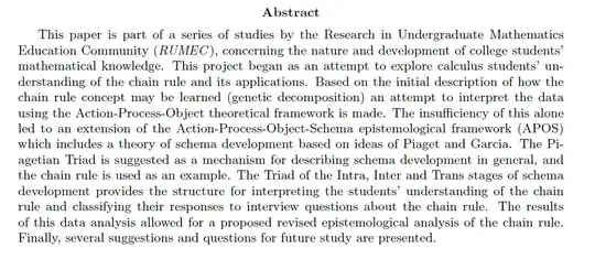

Edit: Since another response mentions using APOS theory to analyze what happens in learning about the chain rule, I thought I would direct you to a source you might find of interest:
Clark, J. M., Cordero, F., Cottrill, J., Czarnocha, B., DeVries, D. J., St John, D., & Vidakovic, D. (1997). Constructing a schema: The case of the chain rule? The Journal of Mathematical Behavior, 16(4), 345-364. Free PDF link.
Some of the sources contained therein or subsequent articles that cite this paper might aid you in your revisiting of the chain rule. Here is an image of the abstract; below the break is my original answer:
