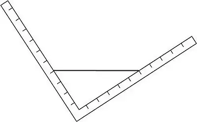

Consider a container of colored liquid inside a right triangle where the triangle can be tilted and the water levels on the left and right side can be measured on a built-in scale. This is called a "water triangle":
The water triangle is rotated until it shows a measurement of 4 units on the left side and 6 units on the right side. Suppose the triangle is tilted even more until the water level on the right side is at 8 units. Predict what the water level in units will be on the left side.

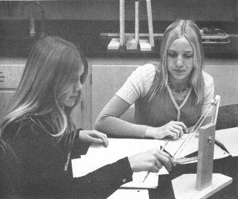

The instrument pictured was created by Barry Kurtz. He writes by email:
I completed my PhD under Bob Karplus at UC Berkeley. I was his last PhD student. My dissertation dealt with teaching for proportional reasoning. I invented the idea of a "water triangle" to teach inverse proportions. These were all made by the workshop at the Lawrence Hall of Science; they were not a commercial item. I doubt any exist today; I certainly don't have any.

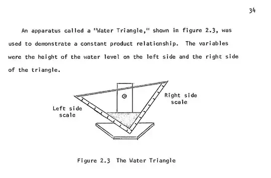

The thesis can be found through DigitalDissertations; the citation is:
Kurtz, Barry Lloyd. A Study of Teaching for Proportional Reasoning. University of California, Berkeley, ProQuest, UMI Dissertations Publishing, 1976.
An image of the water triangle appears on page 34:
Here is an additional picture of an actual water triangle:
