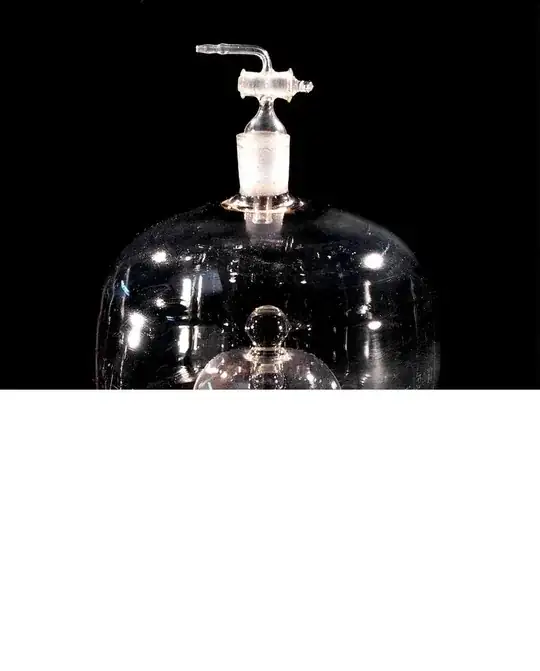

FThe Problem: Given a specific volume, find the dimensions of a cylinder that minimize its surface area. This optimization problem is crucial in designing objects like Le Grand K, where the goal is to reduce air exposure and thereby slow the material's deterioration over time. For Le Grand K, a crucial design feature is that its height equals its diameter.
Why This Shape? Choosing a cylinder with height equal to its diameter optimizes the ratio of volume to surface area, a principle critical in the design of Le Grand K. This geometric optimization reduces the cylinder's exposure to air, minimizing the oxidation and wear over time, thus preserving its mass and, by extension, the standard of the kilogram.
Conclusion: This approach highlights the intersection of mathematical optimization and practical application in material science and metrology. By mathematically determining the dimensions that minimize surface area for a given volume, we can design objects like Le Grand K to ensure longevity and stability in physical standards, which are foundational to scientific measurement and research.
