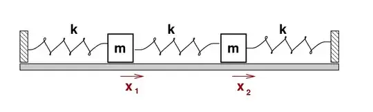

Another physical example involves the following mass and springs system (link to source): A system of two masses connected to each other with a spring and each connected to walls on opposite ends by two more identical springs.
This system has two degrees of freedom and can be represented by a 2D vector space. An intuitive one would be to specify the displacement of both blocks from their equilibrium positions, yielding $(x_1(t), x_2(t))$. However, solving the motion of the blocks in this coordinate system is very complicated with their motion being coupled. Using $x_1 + x_2$ and $x_1 - x_2$ as a basis decouples the equations and makes them much easier to solve (the eigenvalue analysis is what finds this basis).
Transforming the coordinate system using the eigenvector basis reveals that this system has two characteristic ("eigen") motions:
  1. The boxes always move in the same direction back and forth in sync with each other.
  2. The boxes always move in opposite each other, first towards each other, then away from each other.
All other possible motions are linear combinations of these eigenvectors. Thus, the space of motions can be represented by a 2D vector space. There are two natural bases: the physical position basis of $(x_1(t), x_2(t))$, and the eigenmode basis. Transforming to the eigenmode basis is 90% of the solution.
Before seeing the problem worked out, I don't think anyone would naturally see a vector space in the motion of these masses. Here's a video that has demonstrations with two pendulums linked by springs (similar math) and a system of three masses in a similar configuration.
If your students are not ready for calculus or differential equations, you can skip the derivation and present the eigenmodes and the linear combinations of motions--especially if you can demonstrate it physically or with animations.

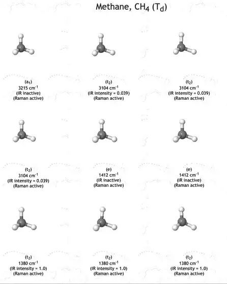

Normal-mode decompositions are used in spectroscopy in chemistry, say, to identify compounds in a mixture. This use of spectroscopy will have been seen by all the chemistry majors at my college by the end of their sophomore year, although they will have had little explanation of the mathematics. They'll see it again in upper-level chemistry along with group theory, where they might learn this gem that was a highlight of my undergraduate education: The irreducible representations of the vibrational symmetries of methane (or other tetrahedral molecule) cannot be computed without the complex numbers. That is to say, the real phenomenon cannot be fully understood with just real numbers. As a liberal arts major, I could rejoice that what was real was complex.
Something I learned later was the significance of the two complex-conjugate irreducible representations that appear in the analysis of methane. The vibrational modes associated to these symmetries are the only ones that generate an oscillating dipole that is necessary for infrared absorption. There are three modes associated to each of the two symmetries, both labeled $t_2$ below but with different frequencies. Further, they oscillate at infrared frequencies (wavenumbers $3156.8\ \text{cm}^{-1},\ 1367.4\ \text{cm}^{-1}$. It is why methane is a powerful greenhouse gas.
Animation showing the nine vibrational normal modes of methane

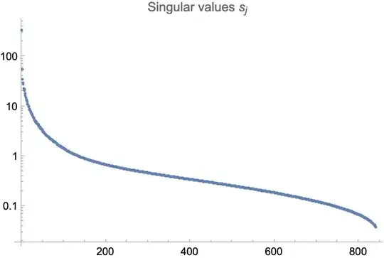

I'm counting it as "science" because we'll use the image of a scientist. Mainly, I introduce the notion this way because it's visual, and it's hard to believe one's eyes. In this application, we're approximating a matrix itself. Since the matrix entries are extracted from image data and vice versa, students can see the approximation improve. The initial matrix entries are the grayscale values (between $0$ and $1$) of the grid of pixels. The singular values this matrix decrease from $s_1=338$ to $s_4=30$, to $s_{50}=3.3$, to $s_{100}=1.4$, and finally to $s_{841}=0.039$ -- a decrease of five orders of magnitude.
a plot of singular values decreasing from 338 to 0.04

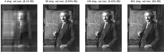

Below are the images from the matrix $$A^*=\sum_{j=1} ^J s_j\, U_{j} (V_j)^T$$ for the singular values up to $J=4,\,50,\,100,\,841$ (all). The relative error (RE) was calculated using matrix 2-norms, $\text{RE} = \|A^*-A\|/\|A\|$, but one should expect a weak correlation between the error of approximating a linear map and how accurate the picture looks. The Frobenius norm gives relative errors of 21%, 5.6%, 3.6%, and 0% respectively, which perhaps seem closer to how the images appear. All norms give estimates much lower than the upper bound $\sum_{j>J} s_j$ deduced above.
Four images of Einstein in progressively sharper detail
Here are a couple of codes for constructing the image approximation (I used this image from Wikipedia, scaled by a factor of 1/3 and converted to grayscale):
