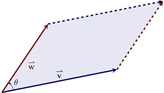

One concept that is quite important in geometric computations is the cross product, and in particular, how to compute the signed area of a triangle.
OSU link
The length of $v \times w$ is the area of the determined parallelogram, twice the area of the triangle given coordinates of its vertices, positive vector up and negative down. This is a fundamental calculation for computing the convex hull of a set of points, for example. Another application is computing the area of a simple polygon by summing the signed areas of triangles determined by each edge and one fixed point—the so-called "shoelace algorithm." This generalizes to computing the signed volume of a tetrahedron, and the volume of simplices in higher dimensions.
See also Wolfram Demo: Signed 2D Triangle Area from the Cross Product of Edge Vectors.
