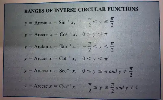

This is from Algebra and Trigonometry by Paul Foerster. His definition has Cot following Cos, which to me is perfectly logical, and what we use in my HS.
Respectfully, Wolfram is no more an authority than Foerster. It seems we agree, and if a student approached me regarding this, I'll stick with "apparently, there are multiple conventions. you need to use what your teacher has stated in their class." Add this to the list. (Deprecating septagon and Pluto were the first two on my long list of changes between college and working in a HS nearly 30 years later.)

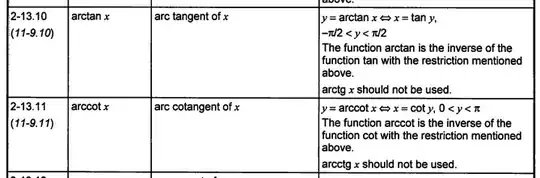

Edit: when I engaged in a related conversation, I was led to This Document which offers -
And at least was written by a body with some authority. If they disagreed with us, I'd have to rethink my strongly held belief. ISO is a well recognized organization offering agree upon standards.
    I see, well, you can disrespect Wolfram all you like, no offense here. I merely used mathworld as an example. It happened the first few things I found in my initial search on the question also lined-up with mathworld. Anyway, thanks for the references. – James S. Cook Feb 22 '22 at 01:09
  • Understood, my wording may have been poor. In the end, I appreciate your question wasn't phrased "which is correct?" but rather, "which do you use?" I'm still wondering if there's a higher source. Wolfram has a PHD in particle physics, Foerster, an MS in Mathematics. Would educated mathematicians consider ISO a legitimate standard for the final say in mathematical notation? – JTP - Apologise to Monica Feb 22 '22 at 02:30
