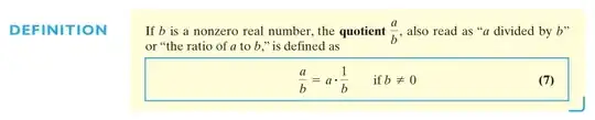

You should be aware that, in standard developments, the two expressions being considered here are true by definition. The quotient $\frac a b$ is just a shorthand ("syntactic sugar") way of writing $a \cdot \frac 1 b$.
For example, here it in Sullivan's Algebra and Trigonometry, Review Section R.1:
Definition of quotient, per Sullivan
You'll see that in any standard textbook on algebra or precalculus. Just looking at other books on my shelf: It's the same in Rosen, Discrete Mathematics, Appendix 1 (Axioms for the Real Numbers, in Exercises). Etc.
Of course, such a definition follows soon after the axiom for real numbers that observes any nonzero real number $b$ has a multiplicative inverse that we denote $\frac 1 b$. This is completely standard, and likewise follows the definitions in abstract algebra that a ring is an object with additive inverses, a division ring is an object with multiplicative inverses, etc. (Such objects including real numbers, obv.)
In short, in the standard development, this equality is not something you can prove, justify, or demonstrate; it's simply an invention of a new shorthand piece of writing. It's founded directly in the assumed multiplicative-inverse axiom for real numbers, and reflects the development at the level of abstract algebra.
However, the interesting thing (and possibly what the OP meant) is that there is a difference in the definition and meaning of $a \div b$ versus $\frac a b $, whose equivalence does indeed take a short proof. Steven Gubkin expanded more on this in his answer to my related question here.
