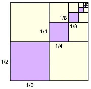

I found another way to present Zenos paradox in a more approachable fashion on the Math Teachers Circle. They pose the problem as follows,
Suppose that Homer would like to walk home. In order to do so, he must walk halfway. After he does this, he must walk half of the remaining distance, and then half that distance, etc. Since he will always have half the remaining distance to go, he will never reach home. Logically, we know that Homer can reach home. So how can we resolve this paradoxical situation?
In this case one can write down the series of distances that Homer has to walk easily and then prove that it is finite by the drawing the following diagramm.
