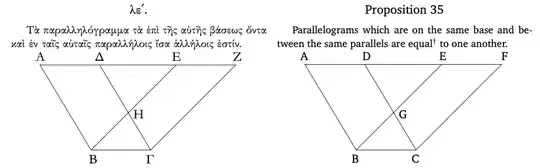

For example, Elements Book I, Proposition 35 says:
Parallelograms which are on the same base and between the same parallels are equal to one another.
(See figure below, from Fitzpatrick's English translation of the Elements, based on the Greek text of Heiberg.)
Notice that "equal", in this usage, does not mean "congruent"; nor does it mean "the same, identical". With this idea as background, the word "congruent" plays an important role: it allows us to say that two figures are not only equal in area but are precisely the same shape, i.e. can be superimposed onto one another.
