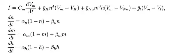

Neither of these models uses calculus explicitly, but more advanced students (especially those who are interested in computational modeling) can be introduced to the Hodgkin-Huxley model:
enter image description here http://en.wikipedia.org/wiki/Hodgkin%E2%80%93Huxley_model
