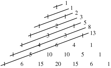

  • Summation properties of the Fibonacci sequence can serve as quasi-interesting facts for the students, but they can also serve you as a way to gently introduce them to induction without really spending an entire unit on it. For instance, work with the students to first observe and then prove that $\sum_{k=0}^n f_k = f_{n+2}-1$. Discuss your proof and why it's necessary, why we can't just observe the pattern and say, "Oh yeah, it keeps going, trust me ..."
