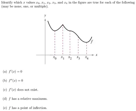

  • Problems based on pictures are harder to Google. This one is based on a Khan Academy problem:
