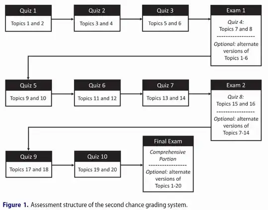

This sounds like a method described in the following paper as second chance grading. The logistics are slightly different (less frequent exams with groups of topics, as opposed to weekly quizzes) but the main idea is similar.
An internet search for "second chance grading" didn't reveal much beyond this paper, but perhaps the term will start to be used for things like this. As one commenter said, "Not every practice in college teaching has a formal identity or name."
Source: Oscar E. Fernandez (2020) Second Chance Grading: An Equitable, Meaningful, and Easy-to-Implement Grading System that Synergizes the Research on Testing for Learning, Mastery Grading, and Growth Mindsets, PRIMUS, DOI: 10.1080/10511970.2020.1772915
Link: https://www.tandfonline.com/doi/full/10.1080/10511970.2020.1772915
The image shown here is from that paper. (It's paywalled but FYI: MAA members have access to all PRIMUS issues.)
