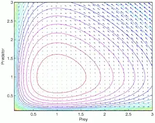

  1. The oscillation of species' populations due to predation.
Vector field formed by population dynamics of two species
