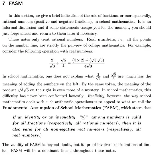

Perhaps an even deeper problem is that, in school, students will frequently make use of the same identity when $a, b, c, d \in \mathbb{R}$. H.H. Wu discusses this in his Pre-Algebra text (MESE 1, MESE 2) as follows:
The main difference between the situation Wu describes and what you describe is that students could actually prove the identity you've put forward. The reason for what is called FASM above is that students have not yet seen limits (in particular, have not yet seen real numbers as limits of convergent rational sequences modulo the appropriate equivalence relation).
As a teacher, you now choose how to proceed with your situation. One choice is to let students work out concrete examples, as suggested by DL Renfro; this is probably one of the best ways to start demystifying the generalization you have mentioned.
Another choice would be to write a proof. If you have students who you think are ready to grasp such a concept (i.e., for whom such a task falls in their ZPD), then you could scaffold it as appropriate, but (as JP Burke points out in a comment) you have now moved into the realm of proving. Moreover, even with a general proof of the fact you've written out, it may not be so clear how directly it can be applied to an example such as:
