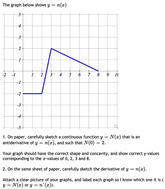

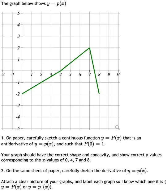

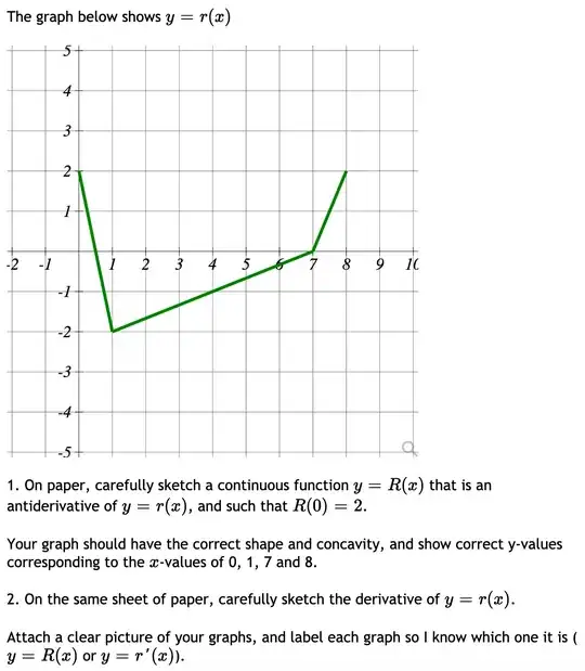

For problems that are beyond just calculations, if you can algorithmically create different problems for each student that are similar in difficulty, this may help with the near-guarantee that someone will be posting all of your problems to Chegg. Also, it may be done with any of the problem ideas you list above.
Here is an exam question I gave this term, together with a few different versions:
Version 1:
Version 2:
Version 3:
I think randomizing as much as possible is a good idea (up to the point where one student faces a much more difficult problem than another student).
