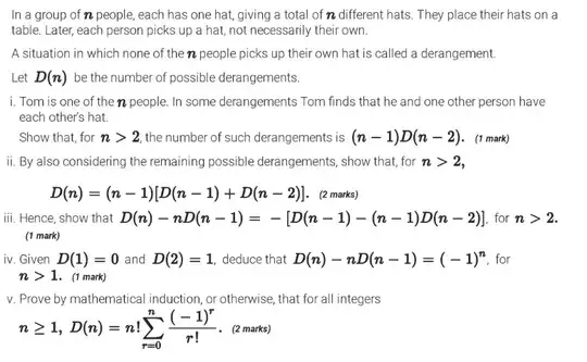

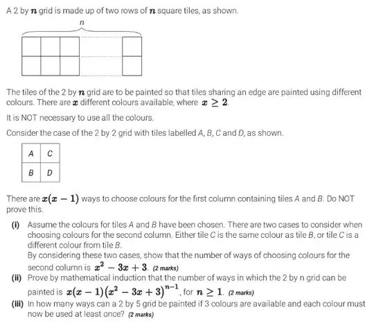

Here in Australia (NSW specifically) the highest level of high school maths in Year 12 has a topic on the logic and methods of proof. This includes general concepts of proof (symbolic logic, truth tables, the contrapositive, proof by contradiction, proof be counterexample, etc.) and some specific methods of proof. I think the best way to get a feel for what the questions are like is just to show you some. Here are two questions from previous exams using these concepts. I have also included a link to a small section of a textbook as an introduction of the logic of proof.
Question 1
Question 2
