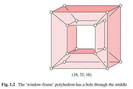

Edelsbrunner's new book,
A short course in computational geometry and topology. Springer, 2014. (Springer link)
might serve as a course skeleton. It is indeed short (110 pages), and written in his laconic but precise style. And beautifully illustrated.
