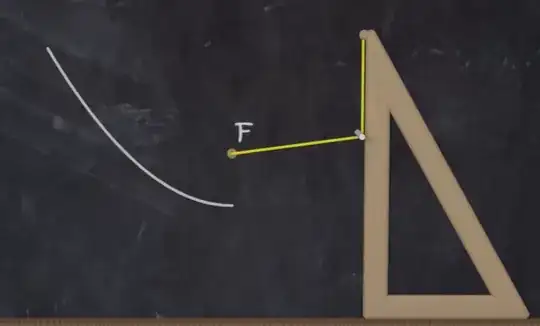

How about drawing an ellipse, a parabola, and a hyperbola, using string and a straightedge:
          Snapshots from MathLapse: "pin-and-string conics."
