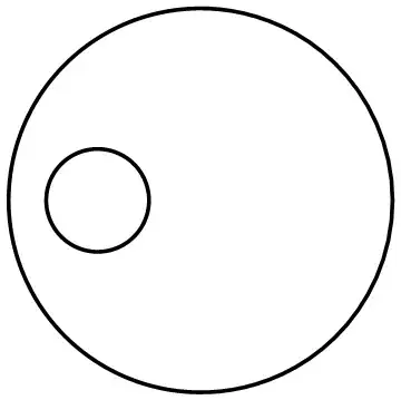

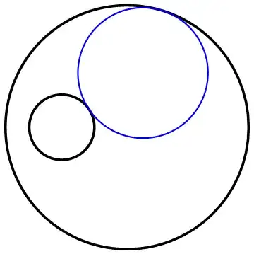

My favorite such a result is the so called Steiner's porism.
It is a statement about the relation of two circles, one inside the other. Such as these two:
We get a so called Steiner chain of circles from this by first drawing a circle that is tangent to both the given circles. We have a lot of freedom in choosing exactly where we draw this new circle (=the first circle of the chain). Then we add a fourth circle (=the second of the cain) that is tangent to the two circles we started with as well as the freshly added third circle. Next we draw a circle tangent to both the two circles we started with as well as the fourth circle, then we draw a circle tangent to circles number 1,2 and 5 etc. We end up with a picture like the one below, where a chain of seven circles, all red, all tangent to the two we started with.
a Steiner chain of length seven
You observe that this chain has a very special property. The seventh circle of the chain happens to be tangent to the first circle of the chain. This says something very special about the relation of the two black circles we started with. Normally it does not happen, but I designed the picture very carefully to make it so.
Initially you might expect that whether this miracle happens depends on where we drew that first circle of the chain. The somewhat surprising result is that this is not the case. Behold! Here's another chain of seven circles. This time all blue. And it also closes after the seventh circle in the chain has been added.
another chain of length seven
Steiner's porism states that this is always the case. The Steiner chain either always closes (with the last circle tangent to the first) after a fixed number of steps (depending on the relation of the two black circles), possibly only after a number of laps, or it never does. Irrespective of the choice of the position of the first circle of the chain. So for our two black circles the chain always closes after the seventh.
The proof is surprisingly simple. That is, after you have covered the basic properties of circle inversions (a theme suggested also by Steven Gubkin in the comments). Namely, you surely agree that the result would be trivial, if the two black circles were concentric. The point is that we can always find an inversion that makes that happen. Furthermore, inversions map circles to circles (or lines as a degenerate case), and preserve tangency.

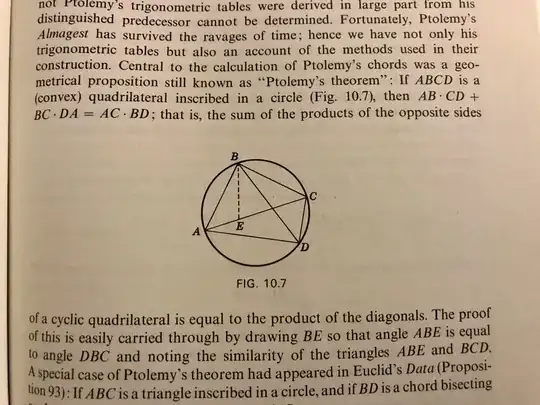

Not quite as beautiful as Morley’s trisection theorem, but here are two I never saw in high school but which I find beautiful:
  • Ptolemy’s theorem, which says that for a cyclic quadrilateral with vertices on a circle, the sum of the products of opposite sides is equal to the product of the diagonals.

    I wrote my master's thesis on how intuitive oblique-angle trigonometry could be if we brought Ptolemy's theorem down to the high school level. – Matthew Daly Nov 16 '19 at 10:12
    @MatthewDaly Can you link to your thesis? – Steven Gubkin Nov 16 '19 at 16:00
    The syntax for getting the alt text to actually show up as the mouseover text is somewhat annoying and not well documented for some reason in the "?" that gives markup help, so I made that happen in this case. – kcrisman Nov 17 '19 at 02:33
  • Ptolemy's inequality also has a beautiful proof with circle inversion. – Steven Gubkin Nov 18 '19 at 15:23

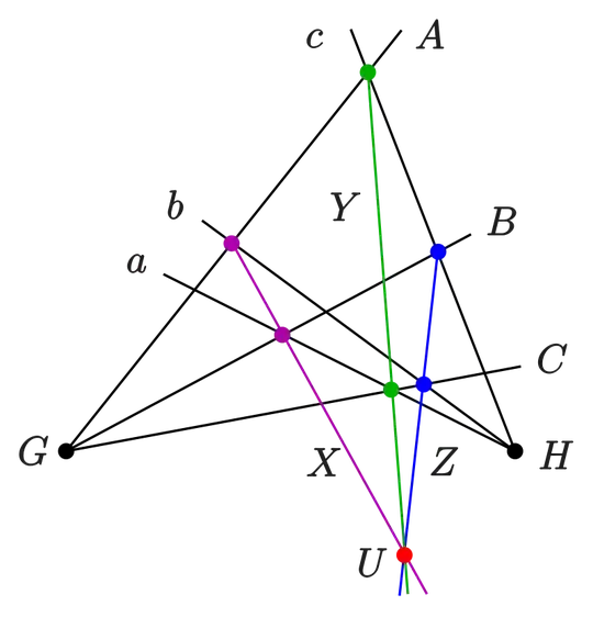

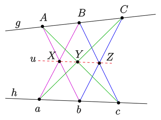

Pappus's Hexagon Theorem has a particularly nice diagram associated with it.
Here, $A$, $B$ and $C$ can be any three points along the line $g$, while $a$, $b$ and $c$ can be any three points along the line $h$. The theorem states that the points $X$, $Y$ and $Z$ at the intersections all lie along a common line.
This theorem was known in antiquity. What is particularly cool is that we can apply the duality principle of projective geometry (which allows us to exchange the roles of points and lines) to get a completely new theorem.
Dual to Pappus's Theorem
The basic principles of duality are
  • line $\leftrightarrow$ point
  • intersection of two lines $\leftrightarrow$ line through two points
  • three lines meeting at a point $\leftrightarrow$ three points along the same line
In the dual version of the theorem, the lines $GA$, $GB$ and $GC$ take on the roles of the points $A$, $B$ and $C$ in the original, while the lines $Ha$, $Hb$ and $Hc$ take on the roles of the points $a$, $b$ and $c$. The points $G$ and $H$ take on the roles of the lines $g$ and $h$ from the original: just as $A$, $B$ and $C$ all lay on the line $g$ in the original, so do the lines $GA$, $GB$ and $GC$ meet at the point $G$.
If we continue to apply these principles to the first diagram, then we arrive at the second diagram. The dual theorem is that the three coloured lines $X$, $Y$ and $Z$ all meet at a single point $U$, just as the three points $X$, $Y$ and $Z$ all lay on a common line $u$ in the original diagram.
I believe (though I am not sure) that this second version was discovered in exactly this way, by applying duality to the first version over a thousand years after the first version was discovered.

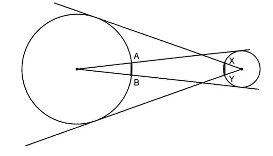

  4. Eyeball theorem
    The tangents to each of two circles from the centre of the other are drawn. Then the line segments $AB$ and $XY$ are equal in length.
    (See also the MathOverflow $\mathbb{R}^3$ eyeball image.)

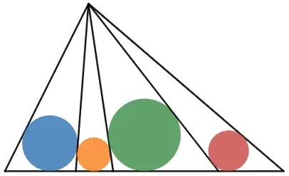

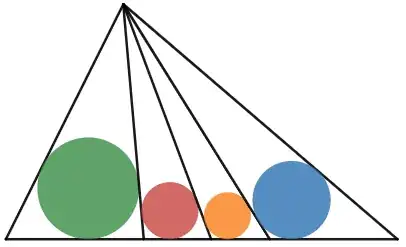

Take any triangle, and draw any number of cevians from the top vertex to the base, with any spacing between the cevians.
In each sub-triangle thus formed, inscribe a circle.
Now rearrange the order of the circles from left to right (but don't change their radii).
Adjust the cevians so that each cevian touches two neighboring circles.
The circles always fit perfectly in the sub-triangles, with no gaps, no matter what their order.
Here is a proof.
