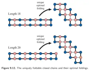

This is perhaps more molecular biology than it is chemistry.
There are some accessible planar geometric questions suggested by the H-P (hydrophobic-hydrophilic) model of protein (amino acid) folding, which could be explored with simple manipulatives (such as K'nex). For example, which proteins in this model have a unique minimum energy folding?
          Figure from Geometric Folding Algorithms: Linkages, Origami, Polyhedra.
Joseph O'Rourke
