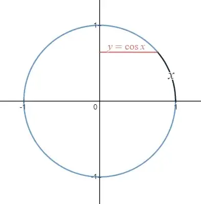

3- In (T) You may call your angle $x$. Note that this is highly confusing in the unit circle presentation. Most books even avoid writing $y=\cos x$, when they introduce cosine. You are essentially asking students to get accustomed to the following picture. Compare that to how students are used to seeing $(x,y)$ in $y=f(x)$.
defining <span class=$\cos x $">
