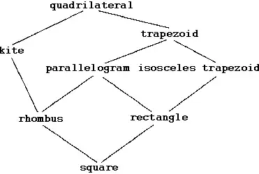

Argument 1: Understanding hierarchical relationships. One of the goals of secondary Geometry is to help students move from a basic conception of "shapes" as individual objects to a more sophisticated notion of "shapes" as generic representatives of categories of objects, and a corresponding focus on the relationships among those categories. (For those who are familiar with the old Van Hiele language for describing geometric understanding, I am talking about the transition from Level 1 to Level 2 and Level 3.).
Students who do not make this transition may fail to understand, for example, that a proof of a property of isosceles trapezoids applies not only to the specific trapezoid represented in a particular diagram, but to any isosceles trapezoid satisfying the hypotheses of the theorem. (See for example Chazan, 1993, particularly at p. 372.)
At a basic level, the goal here is to move students from simpler statements about individual figures ("This is a rectangle because it has four right angles") to claims about nesting of one category of figures inside another category ("All squares are rectangles, but not all rectangles are squares"), with deductive proof making it possible to generalize from a generic case to the category of which it is a representative. At a more advanced level, students are expected to develop an understanding of a hierarchical relationship among types of figures, as shown below. (Image source)
hierarchical model of quadrilaterals
Thus for example students should know (and be able to prove!) conditional statements like the following examples:
  • If $ABCD$ is both a rectangle and a rhombus, then it is a square (and conversely if $ABCD$ is a square then it is both a rectangle and a rhombus)
  • If $ABCD$ is both a parallelogram and a kite, then it is a rhombus (and conversely if it is a rhombus then it is both a parallelogram and a kite).
  • If $ABCD$ is both an isosceles trapezoid and a parallelogram, then it is a rectangle (and conversely...)
  • Every rectangle is a parallelogram (but not every parallelogram is a rectangle); every rhombus is a parallelogram (but not every parallelogram is a rhombus); every parallelogram is a trapezoid (but not every trapezoid is a parallelogram); every trapezoid is a quadrilateral (but not every quadrilateral is a trapezoid).
  • etc.
Note by the way that in the classification scheme shown above, different types of quadrilaterals are defined inclusively, rather than exclusively. Not all curricula follow this convention consistently; for a historical perspective on quadrilateral definitions and classification, see my answer to a related question.
Now if we were to stipulate, for the sake of discussion, that understanding these hierarchical relationships is one of the goals of the curriculum, consider what would happen if the categories of "kite" and "rhombus" were removed or omitted. Roughly 1/3 of the diagram above, and a corresponding number of hierarchical relationships would simply disappear -- there would be no way to even talk about them! We need kites and rhombi in the lexicon so that we can have a fully-developed theory of quadrilaterals.

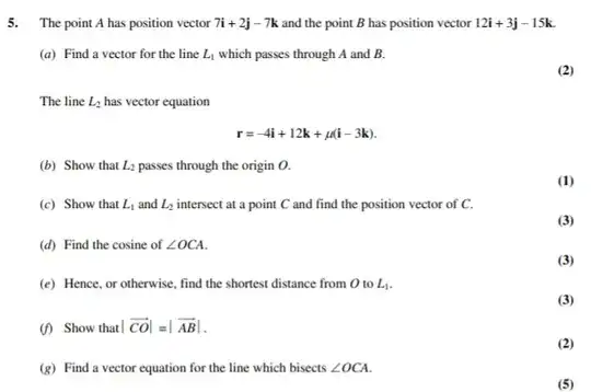

The observation that a rhombus's diagonals bisect its internal angles gives rise to an efficient method to find an angle bisector.
Here, a British national-exam question hints this method to the candidate:enter image description here

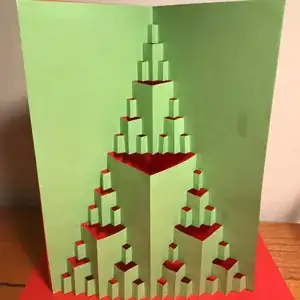

Understanding parallelograms and rhombi is quite useful in pop-up card design:
     AgolXmas
Constructed by Ian Agol. Twitter link; "inspired by @divbyzero's tweet." 19Dec2020.
