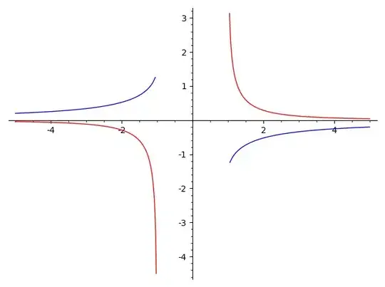

Find the indefinite integral $$ I=\int\dfrac{dx}{x\sqrt{x^{2}-1}}. $$ Some of my students gave the following answer.
Let $t=1/x$ then $dx=-1/t^{2}dt$, so we get $$ I=\int\dfrac{-1/t^{2}dt}{\frac{1}{t}\sqrt{\frac{1}{t^{2}}-1}}=\int\dfrac{-dt}{\sqrt{1-t^{2}}}=-\arcsin\left(t\right)+C=-\arcsin\left(\frac{1}{x}\right)+C. $$
Sometimes, I accept this answer since it gives a quick general antiderivative. However, the problem here is that we should write $$ \int\dfrac{-1/t^{2}dt}{\frac{1}{t}\sqrt{\frac{1}{t^{2}}-1}}=\int\dfrac{-\left|t\right|dt}{t\sqrt{1-t^{2}}}. $$ Then we end up with the answer $$ \int\dfrac{dx}{x\sqrt{x^{2}-1}}=\begin{cases} -\arcsin\left(\dfrac{1}{x}\right)+C & \text{for }x>1,\\ \arcsin\left(\dfrac{1}{x}\right)+C & \text{for }x<-1. \end{cases} $$ In your teaching practice, how would you usually proceed?
PS. We may encounter the same issue in many other problems. For example, find $\int\sqrt{1-x^{2}}dx$. Then if we let $x=\sin\left(t\right)$ then $\sqrt{1-\sin^{2}\left(t\right)}$ should be $\left|\cos\left(t\right)\right|$. So now we need to explain a bit here to our naive students. Of course, avoiding these kinds of problems is the quickest way to make our teaching job easier. However, we need to prepare a good way of explanining or handing these types of problems. That's what I want to know.

I'd avoid giving problems like that to students first learning indefinite integrals (either by not asking it at all, or specifying the range x>1 in the question). It's a subtle algebraic trap, and if the goal is to teach students the mechanics of integration, it's going to be distracting rather than helpful.
It might be an interesting question in a more advanced class, or as a question which is marked as difficult where students are expected (or told) to investigate their answer more carefully. (For instance, graphing the functions will quickly reveal that there's a problem with the first solution, and looking at the graphs is probably enough to figure out what the fixed solution should look like, though figuring out why might take students a while.)

So in your case, I would go more naive as well. Do a very rough sketch of $\arcsin(1/x)$ (you can basically do this by drawing $-\arcsin(x)$ and then "flipping over $x=1$ to infinity"), and then ask them whether this function is increasing or decreasing. When $x<-1$ it should be increasing (in fact, it should be increasing on the whole domain), so its derivative should be positive (by whichever numbering of the fundamental theorems of calculus you like). But $\frac{1}{x\sqrt{x^2-1}}$ is definitely negative there.
Now you can explain why you are picky, instead of just being picky because of some "dumb" $|x|$ thing students may find to be a little too abstract.

It is interesting to note that if we instead write the antiderivative as $I=-\arctan\left(\frac{1}{\sqrt{x^2-1}}\right)$, then this form is valid for both $x<1$ and $x>1$. In other words, using this arctan representation, we avoid a need for a piecewise representation for the antiderivative.
This problem is well suited for formative assessment. I would give full credit for an answer of the form $I=-\arcsin\left(\frac{1}{x}\right)$, and then use this as a launching point for a discussion of these more involved issues that you have uncovered, depending on the mathematical maturity of the student.
