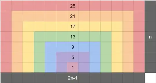

For a nice example of additive telescopy, in this answer I show how the "proof by picture" below can be mechanically discovered and rigorized by applying a 2-dimensional form of telescopy - which allows us to view a sequence of rectangles as being built-up layer-by-layer from successive differences of prior rectangles - as if they were built by a 2-D printer in FlatLand.
$$ \large \color{PaleVioletRed}1 + \color{DarkViolet}5 + \color{DodgerBlue}9 + \dots + \color{LightCoral}{(4n-3)}\, =\, n(2n-1) = 2n^2-n$$
