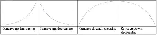

I'd like to find more varied settings for exponential functions, including (it is hoped) some that are concave up or down, and for each of those some that are increasing and some that are decreasing.

  • Thanks. Your scientific examples reminded me that I've seen exponential models of the kidney's elimination of drugs from the blood. Looking for that example on the web I found a nice activity at https://illuminations.nctm.org/lesson.aspx?id=3081. Can you tell me, though, which of your examples would correspond to each of the four graphs I've added to my question? I think most are concave up and decreasing, as positive quantities draw closer to zero. – Chaim Apr 19 '18 at 17:34

    I really think you should figure it yourself (some of the learning is from the research), but: a is mostly graph 1, b is type 2 for decay and type 3 for buildup. c is type 2 and 3 (depending on POV, concentrating or diluting). Note the initial and equilbrium levels are likely nonzero. d is 2 charging and 3 discharging. e is generally 3. f is 2 compaction and 3 velocity. g is 2. h is 2. i is all of them (it's a Gaussian curve or parts of it). j same as i. k same as i. [You should draw a Gaussian bell curve and label it with your graphs: 1, 3, 4, 2. A sigmoid is 1, 3.] – guest Apr 19 '18 at 17:59
  • graph 4 is probably the hardest to come up with examples of (e.g. reaction catalyzed by products, looking at the starting material point of view). It corresponds to graph 1 (which is the products view of explosive growth). [Another graph 4 example is the incumbent product market share, e.g. blackberry, as another product I-phone, begins explosive growth. Things look OK for Blackberry at first, minor near term effects, but get bad as the I-phone explodes.] – guest Apr 19 '18 at 18:04
