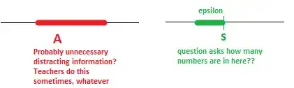

I'll focus on question 2 from a perspective of "maybe the right thing to think about is: what happens in the students' minds while they read this question?"
When you say "Suppose $A⊆R$ is nonempty and bounded above," the following thing happens in my mind before I continue reading:
This picture takes up very little working memory for me because I am familiar with how I can mess with it. This may not happen in their minds. They may think of $A$ as a set that follows arcane rules. After all, the set is arbitrary. It may feel pointless to think about the set at this point. Have the students practiced how to read a quantified phrase like this? Maybe you are assuming they know this from a previous course.
Then you say "Let $s=sup(A)$, and let $ε>0$ be arbitrary."
My new picture is this, and it's important that even though $\epsilon$ is a real number, I haven't placed it on the real line, because the use of the letter $\epsilon$ implies to an expert that this would be the wrong way to think about this specific real number.
Then you say "What can we say about the interval $(s−ε,s]$?"
We are deep into multiple objects at this point. A weaker student's picture may look as poor as this right now:
The student is suspicious that they have missed something (and they have; they didn't notice that the way $s$ was introduced is important) but their mental picture is highly deficient, so they said the best thing they could with what they were working with: "there are infinitely many real numbers in any non-trivial interval."
Basically I agree those answers are terrible. But investigating more explicitly with the students what should happen in their brains when they read a sentence with multiple quantifiers would be the in-class exercise I suggest. They may not realize that every time a variable is quantified, they should now be able to think about it or even have a good schematic picture of it.
