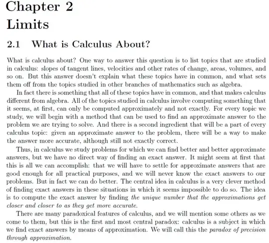

I recommend a newer Calculus textbook, which was published earlier this year: DJ Velleman's text, "Calculus: A Rigorous Approach" (link; also mentioned in my answer to MESE 11971). In the introduction, there is a "note to the instructor" as follows:
One of the "novel approaches" in this text is its presentation and notation of and around limits:
I would say that from the perspective of this text, the "main point" as concerns limits fits into a broader focus around which the topic of Calculus is structured: that which Velleman calls the paradox of precision through approximation. Here is one final excerpt in that direction, which is followed in the text by concrete, motivating examples (and section 2.2 is entitled What Does "Limit" Mean?).
I believe that the subtle but important change(s) in notation, along with the structuring of this text around broader themes in Calculus, make it a worthy candidate for the sort of treatment of limits (and beyond) about which you ask.
