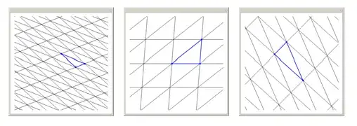

A possibility, requiring one definition: What is a tiling of the plane with an infinite supply of congruent copies of a single tile (technically, a monohedral tiling). This can go as deep as you'd like, perhaps in stringing together several mini-sessions.
  1. Can every triangle tile the plane? (Yes.) Form parallelograms, then argue that a parallelogram tiles the plane.

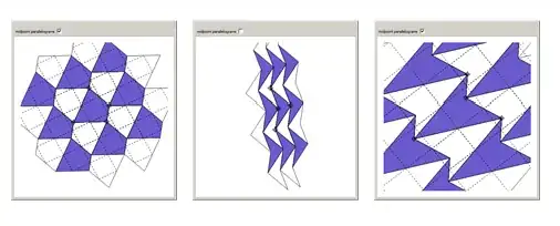

  2. Can every quadrilateral tile the plane? (Yes.) This is not as easy to see. Easier if restricted to convex quads.

    Cited in Mathworld, with this reference: Wells, D. The Penguin Dictionary of Curious and Interesting Geometry. London: Penguin, pp. 177-179, 208, and 211, 1991.
