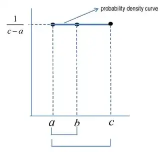

This is treason, but anyway:
If your students can jump from "ratio of outcomes in $A$ over all possible outcomes" to "ratio of length of interval, over total feasible length", then the answer why probability can be represented as the area under a curve could half-jokingly (but only half-) be "for convenience, since we set the height of the curve at a value that it will replicate our "ratio" approach".
The "ratio approach" would require that
$$P([a,b]) = \frac {length[a,b]}{length[a,c]} = (b-a)\cdot \frac {1}{c-a}$$
Instead of doing a division in one dimension, we do a multiplication in two dimensions, by setting the probability density curve at height $1/(c-a)$.
With any other distribution, one has to move from simple multiplication of the sizes of a rectangle, to integration to find the area under a curve.
