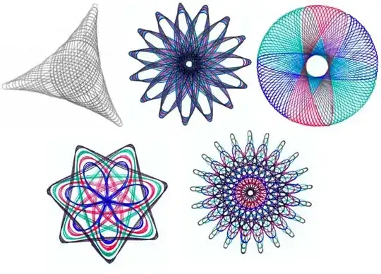

Some nice geometrical applications arise in the analysis of periodical curves such as Roulettes (Spirograph curves), Star Polygons, etc. Concrete experience with implementations in toys like Spirograph also provides excellent motivation for more abstract concepts such as cyclic groups.
Bill Dubuque
  • 1,038
    This is a good one, and it's how I introduced $\gcd$ to a class of education students. I drew a couple of ${n/k}$ star polygons and handed out a sheet with 12 sets of 12 vertices of a regular dodecagon for creating the various ${12/k}$. It was moderately successful, asking them to figure out how many "pieces" the star polygons would have, and what relationship between $n$ and $k$ would cause the star to be connected. – pjs36 May 17 '17 at 13:10
