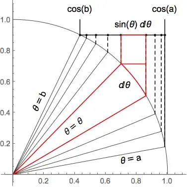

The integrals of sine and cosine have a nice geometric interpretation, if you and your students are comfortable treating the differential of a circular arc as equivalent to a straight hypotenuse (in the limit as $\Delta\theta \rightarrow 0$). This is perhaps more of an example than a simple exercise for the student. But I think it answers the OP's objective of thinking geometrically about integrals instead of in terms of algebraic antidifferentiation.
For instance, $\int_a^b \sin\theta \; d\theta = \cos a - \cos b$:
One may find the reasoning (which I assume the reader can fill in) a little loose, but it's a true picture that helps give the student a new perspective on sine and cosine. I prove the ratio of the lengths of an arc and its subtending chord approaches $1$ as the lengths approach zero as well as prove the derivatives in a similar geometric fashion, so it feels more comfortable to me.
This idea may be found in Pascal, Traité des sinus du quart de cercle 1659, Prop. I: La somme des sinus d’un arc quelconque du quart de cercle est égale à la portion de la base comprise entre les sinus extrêmes multipliée par le rayon.

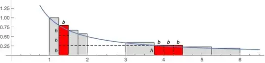

Based on a discovery of Gregory of St. Vincent, Opus geometricum quadraturae circuli et sectionum coni (1647), Props. CVIII-CIX, 585-586:
Consider integrating the hyperbola $y = 1/x$:
Mathematica graphics
If the $x$ coordinates of a partition of the interval from $1$ to $b=2$ are multiplied by $a=3$, the partition is transformed to one of the interval from $a = 3$ to $ab=6$. Furthermore, all the rectangles in a Riemann sum over $[1,2]$ are transformed to equal rectangles in a Riemann sum over $[3,6]$, since the bases are multiplied by $a=3$ and the heights multiplied by $1/a=1/3$.
  1. Why does this show $\int_1^2 {dx \over x} = \int_3^6 {dx \over x}$? Argue similarly that $\int_1^b {dx \over x} = \int_a^{ab} {dx \over x}$ for any $a,b>0$).
  2. Let $L(a) = \int_1^a {dx \over x}$. Show that $L(ab)=L(a)+L(b)$. Such a function is called a logarithmic function. (First argue that $\int_1^{ab} {dx \over x} = \int_1^{a} {dx \over x} + \int_a^{ab} {dx \over x}$.)
  3. Given that $L(a)$ is a logarithm, estimate its base. (First recall what the value of $\log_B(B)$ is.)
