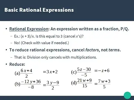

For what it's worth, here's the slide on that topic from my college algebra class:
Note that I start by checking a counterexample of that common reduction error. In accordance with my theme that the essence of algebraic thought is to think about inverse operations, I try to connect with the intuition that it makes sense that division only cancels with multiplying (not addition or any other operation). I agree with zipirovich that it's important to be previously drilling students on the names of things, so that we can concisely state the important difference at this point (factors vs. terms). Then I run a few exercises (with answers hidden until another mouse-click by me).
This is no silver bullet in my experience; students still commonly have trouble on later days -- perhaps they find fractions so unpleasant that they just shut off that part of the brain whenever rational expressions show up. But connecting with the inverse operations gets a few heads nodding, and perhaps as important, continues the broad theme of the course that hopefully pays off on later days.
