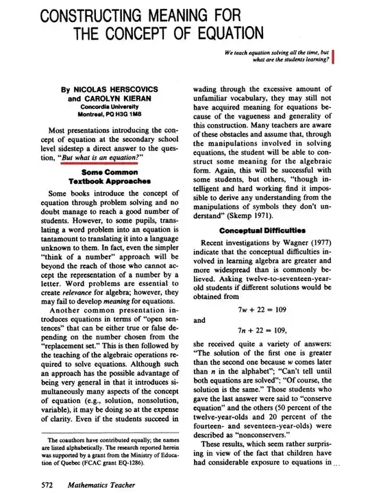

The first name that comes to my mind around a question such as this (i.e., related to equations or equality) is Carolyn Kieran. For example, see:
Herscovics, N., & Kieran, C. (1980). Constructing meaning for the concept of equation. The Mathematics Teacher, 73(8), 572-580. JSTOR.
Here is the first page:
And here is the definition suggested, though you would need to read the full article to see what is meant by, e.g., arithmetic identity (although I think you could well guess it):
